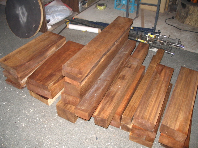

Dave and I became the proud owners of this lot yesterday, all well quartered and a mixture of AA and AAA.
It should keep us busy for a few years - once it dries.
It's been cut about 4 months so I'm wondering whether it's better to seal it and leave it as is, to dry for a few years or cut it into thinner planks, seal and rack.
I'm hoping that one of our learned Zootmen will be able to give us some advice.
The billets are around 3-4" thick but one of the side billets is around 6" x 6".
The shed sure smells good.
And no. I haven't rolled in it.(yet)
Bob Connor
Geelong, Australia

Bob,
You should give Tim a ring, he's back from Tassi and has more experience with resaw and storage of Aussie Blackwood for guitar use than just about anyone, best of all he is very helpful with the knowledge.
One thing I would NOT wait to do is sealing the end grain, either hot wax dip or PVC pipe glue is good, in a pinch you can rub a good bit of PVA glue into the ends or even acrylic paint but get something on there ASAP as it can all go south real quick, 4 month is not long off the saw.

Bob very nice Blackwood. If it were mine I would seal the ends and cut it into sets and sticker it. It will dry much faster. Tim may have a different approach.

I'd seal it NOW and put most of it away in billet form to cure. Figure a year per inch of thickness for air drying. Cutting it now could lead to the sets becoming "potato chips" as the stresses in the wood will want to work out...even if stickered. Been there, done that with some walnut that was "supposedly" about 4 years from cutting. It had been sealed and air dried, but as soon as I cut into it to make sets it started to curl. Your stuff is too nice to chance it.
Maybe try cutting the "driest" billet and see what happens, but I would store away as much as possible just for safety sake.

Hank was the walnut wet or kiln dried? I have been cutting wet wood into sets for 3-4 years now and sticker with weights. They dry perfectly flat. The first 10 days to 2 weeks I keep it covered loosely with clear plastic. When the droplets on the plastic start to subside I uncover and put a fan on low to circulate air. Usually down to 8-10% MC within 4-6 weeks.

The walnut was about 3" thick and had been air drying for 4 years. There was a bit of moisture in the very center, but certainly not what a fresh cut billet would contain. There was a good amount of figure in the piece, but others cut later from the same log came out fine. Go figure! By the way, the piece started to curl before I had even finished the first slice on the resaw. Should have figured something was up, but then I always was a slow learner!
Anyway, since there seems to be a large supply in Bob's shop, I (personally) would try to age as much as possible before I cut it into sets. But that's just my approach...as always YMMV.

Thanks Hank and Bob.
I did get a phone call from Tim last night who suggested
sealing the ends and putting it away for at least a year before doing anything else with it.
I may try resawing one of the smaller billets to see what happens.
This wood is all from the same tree.

PostPosted: Tue May 01, 2007 12:23 pm
Bob,
I cut up a bunch of Blackwood that Tim sent over last summer and this is my experience. If the wood has wild grain (as apposed to just flame) then leave it alone for a couple of years. If the grain is quite uniform but just exhibits good flame, you can cut it now and sticker it and it will dry faster with less risk of waste. The deciding factor is how wild the grain is, adding stresses to the wood. I agree with Bob, the sooner you cut it the more quickly it becomes stable so you run less risk of loss to checking and other issues but if the grain is wild it won't dry well and likely won't even cut well without a good agressive band on a big saw!

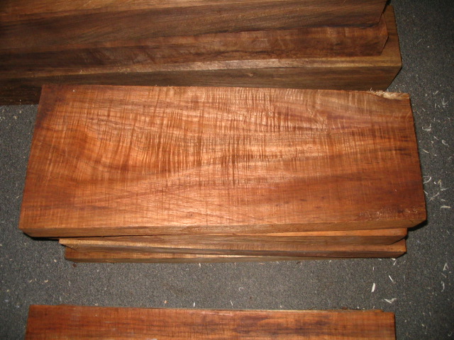

Most of it is straight grained with varying amounts of flame in it.
The billet in the second photo is probably the wildest grain of the the lot.
I'm not sure how your 'wild' scale is calibrated so what do you reckon we should do with that piece.
It's also the nicest piece so we really don't want to spoil it.

Hey Bob,
I think that stuff would be fine to saw, sticker and weight. As Larry eluded, it was the buttress sets that caused issues. These were stumpwood billets with grain going in every direction! Beautiful to look at but I think that the wood needs to nice and dry, right through, before sawing, either that or saw thick, sticker often and park a truck on it!
But again, your sets look like nice "typical" but very nice flame billets and my experience is that they saw nicely and stay fairly flat through the drying process, just sticker them and add some weight.
Good luck!
